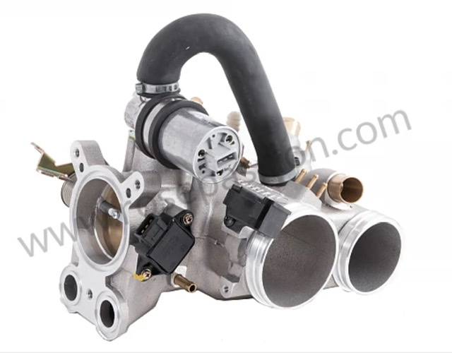

The genuine ISCV is a Bosch 0 280 140 543
I configured the 2 required outputs and I found a schematic on the Motec library for a similar valve.
But the parameters were for a M4 ECU. With the M600 it’s a different setup so if someone has already used that valve and would like to share it would be greatly appreciated.
It’s the same ISCV on all 993s regardless of the engine. (NA or not)

It is a pity that you have the M600 already, as this build would have had an M150 recommended for it, especially if you are fitting knock and Flex Fuel, as well as controlling the ISCV. If you had an M150 on it I would have also recommended ditching the ISCV and cable throttle and replacing them with a DBW throttle system.
With the M1 you would have been able to run the engine in a full sequential mode as well.

I chose the M600 because my car is from 1995 and I don’t have FBW, cam phasing, nor modern goodies.
I though it would have been be easier this way..
The M600 support sequential injection
The TB on this car is very specific and can’t be swapped easily.
Of course it would still be possible to had a servo to actuate the throttle but getting rid of the iscv would be another story.
