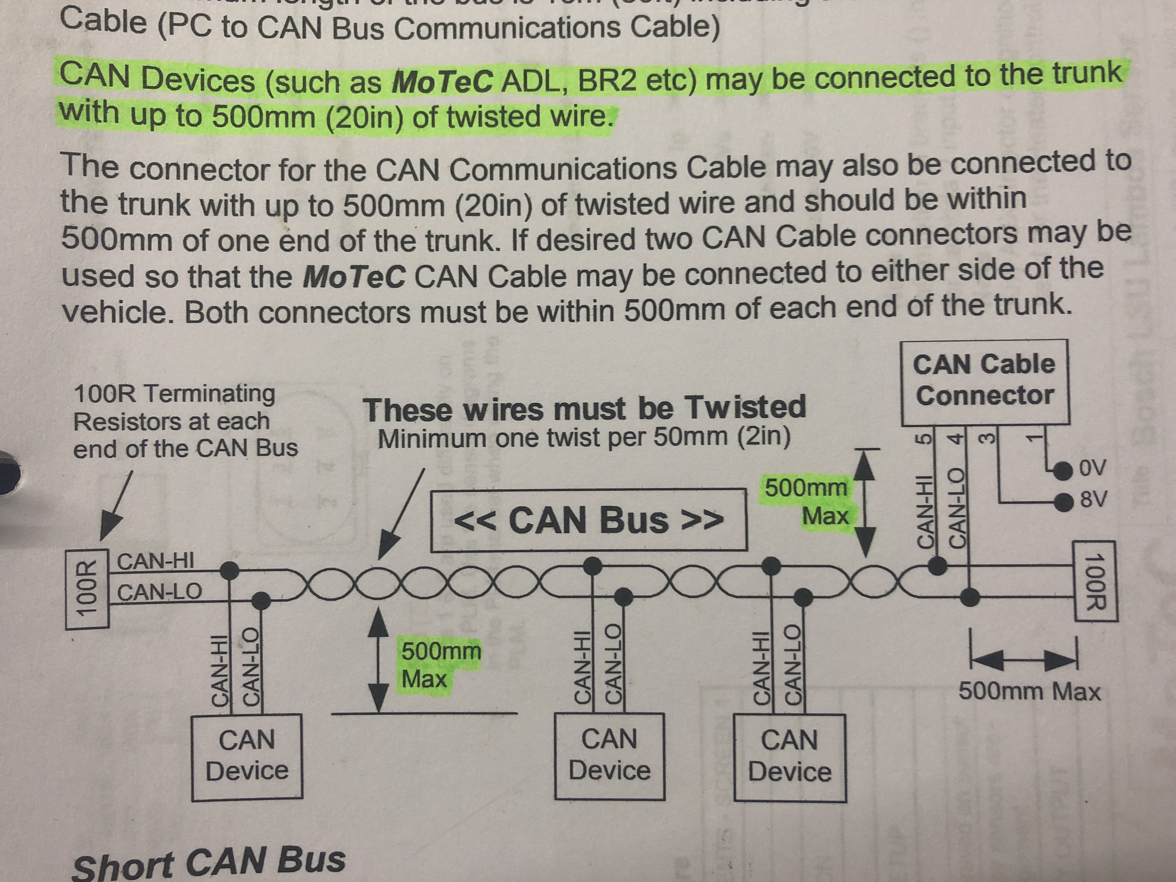

Hi All
On MoTeC Mx00 series user menu say 500mm is the maximum distance from CAN device to the trunk.
What happens if I have the CAN device is 1m from the main CAN bus?
Thanks a lot!

Postby David Ferguson on Tue Sep 10, 2019 2:28 am
You will exceed the spec, but it is likely to work.

Postby junnan yue on Wed Sep 11, 2019 6:19 pm
Hi David
Thanks for helping.
But what I should do to make it work if the distance is more then 500mm.

Postby David Ferguson on Thu Sep 12, 2019 2:26 am
What you need to do is extend the trunk.
Instead of splicing onto the trunk, break it there and extend both legs until the are within 0.5m of your device, splice at that point. Often you can make this right at the back of a connector for a device.

Postby Herrubermensch on Sun Sep 15, 2019 9:12 am
Exactly. Otherwise known as making the main CAN bus run "in and out" or "back and forth" until a foot before the sensor, dash, or other CAN bus item.
