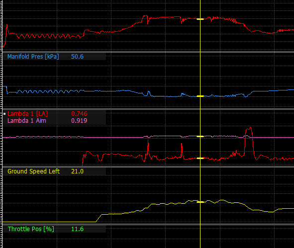

I am having trouble with the lambda sensor. Basically it's always reading rich. No matter what I do to the tune, it's it's always fluctuating around 0.8. I can cut fuel with overall trim all the way to 50% and it still shows rich.

Quick update for everyone. I was still not able to find the cause of the problem. I have looked at the logged data from the test session and can see what appears to be an offset.
I need to double check if the grounding or the 5/8v sensor wire are interfering with the lambda.
Fluctuations look correct, but everything is extremely rich. Changing the Overall Trim to even -30% does not change anything in the logs. Even tho i can hear the engine rev dramatically faster making me think it is going lean.
