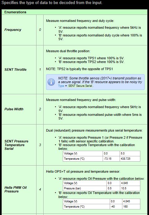

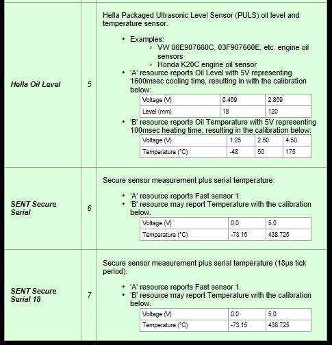

Several different SENT devices are supported on the M1 ECU that you have, even potentially without going down the M1 build path.
If you are running the latest version of the GP package, you will find that the position sensor configuration for the actuator has the ability to choose a digital decode.
