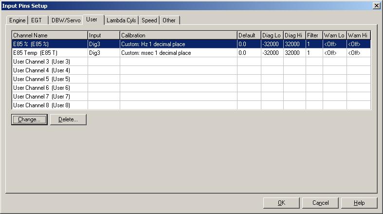

I have set up Dig in 3 with speed, Hz (alcohol), and dig in 4 is set up with msecs measuring (temp).
I dont get any raw signal, it is 0

you DID setup the input channel under the Adjust > Sensor Setup > Input Setup > User Tab > User X = Dig3 and user Y = Dig4? right? ;)
Save you from doing that daisy chaining that you did.
Also make sure that you turn on the Efficency Z and load Z and add the appropiate user table to each.
