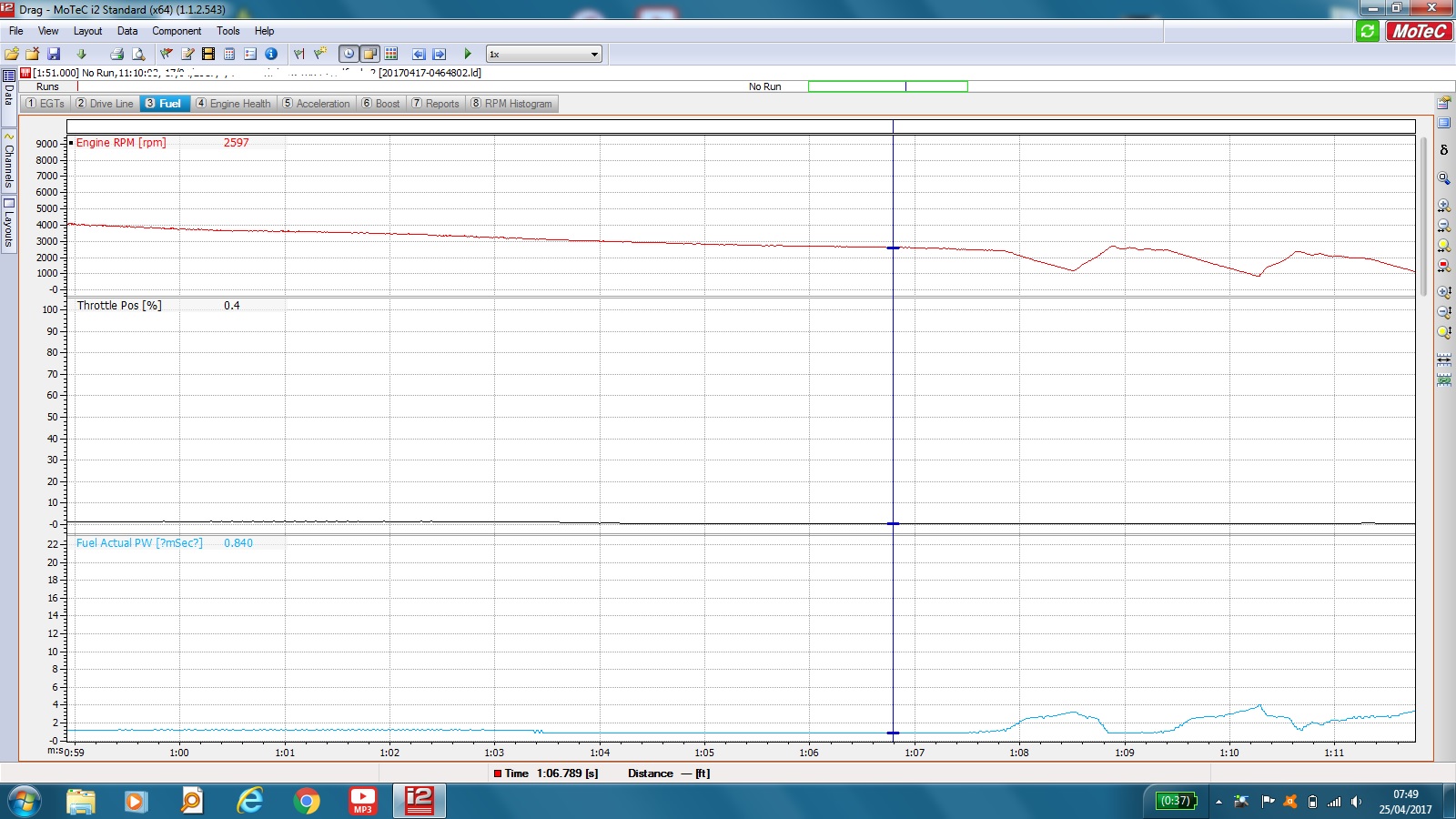

Postby CPL Racing on Tue Apr 25, 2017 5:58 pm
Below is a screenshot showing the problem
Unj opening on decell.jpg (424.16 KiB) Viewed 24662 times

Postby Russ on Tue Apr 25, 2017 10:40 pm
Whats your idle activate rpm set at?

Postby CPL Racing on Tue Apr 25, 2017 11:27 pm
Hi russ
Idle activate rpm is set to 1800
I don't have an idle valve, I have itbs with the idle controlled with ign comp.
Is the injector pulse modified on return to idle ?

Postby Russ on Tue Apr 25, 2017 11:52 pm
Hello :)
Could be wrong but suspect overrun fuel cut will turn off when rpm drops back into idle area.

Postby CPL Racing on Wed Apr 26, 2017 12:28 am
Thanks I'll try lowering the rpm

Postby David Ferguson on Wed Apr 26, 2017 12:50 am
Any chance your Injector Battery compensation is 840 uSec at that voltage/pressure? You are looking at actual pulse width, (not effective pulse width) and I would expect the the injector dead times would be included in this pulse width.
