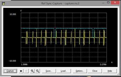

Postby thedriver75 on Fri Apr 10, 2015 12:04 am
Reading some of the other cranking issue problems and resolutions, I just did a Ref Capture as a pre-emptive possible answer.

Postby sarbetto on Fri Apr 17, 2015 9:53 pm
Hello , Try to approach the sensor ref .
It does not seem a good sign .
Or before you change the position of the ref tries to change the ref trigger voltage.

Postby stevieturbo on Sat Apr 18, 2015 3:33 am
thedriver75 wrote:Reading some of the other cranking issue problems and resolutions, I just did a Ref Capture as a pre-emptive possible answer.
A screen shot only shows a small picture.
But it does look like a good clean signal with good voltage levels.
As to whether they match your setup config...no idea.
