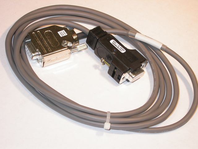

Unusual problem you have there. The M48 definitely requires a PCI cable which is the part number you have mentioned in your post. Are these the cables that you have there? (see attachment)
If they are then you should contact your dealer or MoTeC USA for replacements.
PCI Cable Pic
