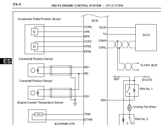

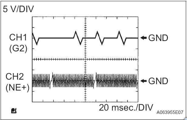

I Attached the ECU wire and Ref/ Sync sensor photos
Ref/Sync
echo 1.JPG (33.37 KiB) Viewed 17947 times
Echo ecu wrie

Re: How to set the REF/SYN mode of Toyata 1NZ-FE engine

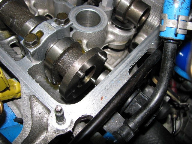

Postby Fueltank-Tai on Thu Jul 30, 2009 4:38 pm
I attached Cam and Crank sensor photos
Crank sensor
Cam Sensor

Postby RossB on Thu Jul 30, 2009 5:30 pm
You need to remove 2 of the teeth from the cam. The tooth you keep should be the one that occurs roughly 180 degrees (crank rotation) from where the missing teeth on the crank trigger pass the crank sensor. You will probably have a chouce of 2 teeth to keep, it doesn't matter which one from the two you choose.

Postby Fueltank-Tai on Thu Jul 30, 2009 9:32 pm
Dear RossB:
I started the engine . I post my setup for all .
Totayo Echo 1NZ-FE 1500cc ( Japanese modal )
Ref sensor is with two wire. ( Magnetic )
Sync sensor is with two wire ( Magnetic)
Ref 36-2 stock
Syn 4-1 stock
note : i remove two teeth from cam .
