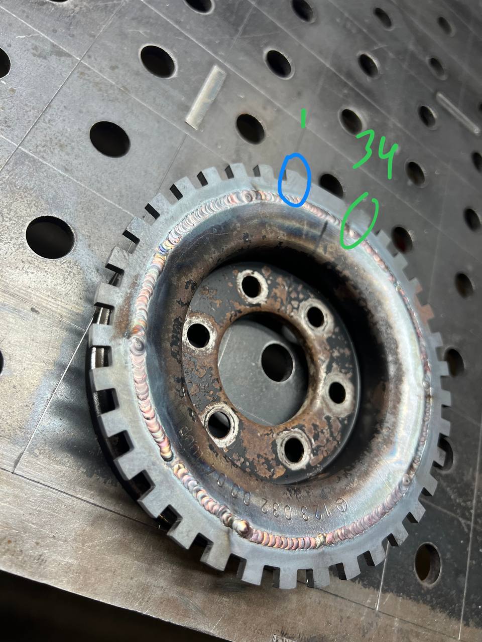

Stephen! thank you for the reply! Unfortunately now i have only M8 also as an opportunity to buy but it seems that camshaft sensor is highly needed. I will invent it today and add to my system. Can i ask for a opinion about the camshaft pattern? Crankshaft is 36-2:

Any ECU on the Market will need a Sync sensor of some sort to be able to operate in a sequential mode, not just the MoTeC ECU's. You can have camshaft mounted "crank" triggers but this is not recommended.
36-2 is a common crank trigger pattern and is acceptable to use.

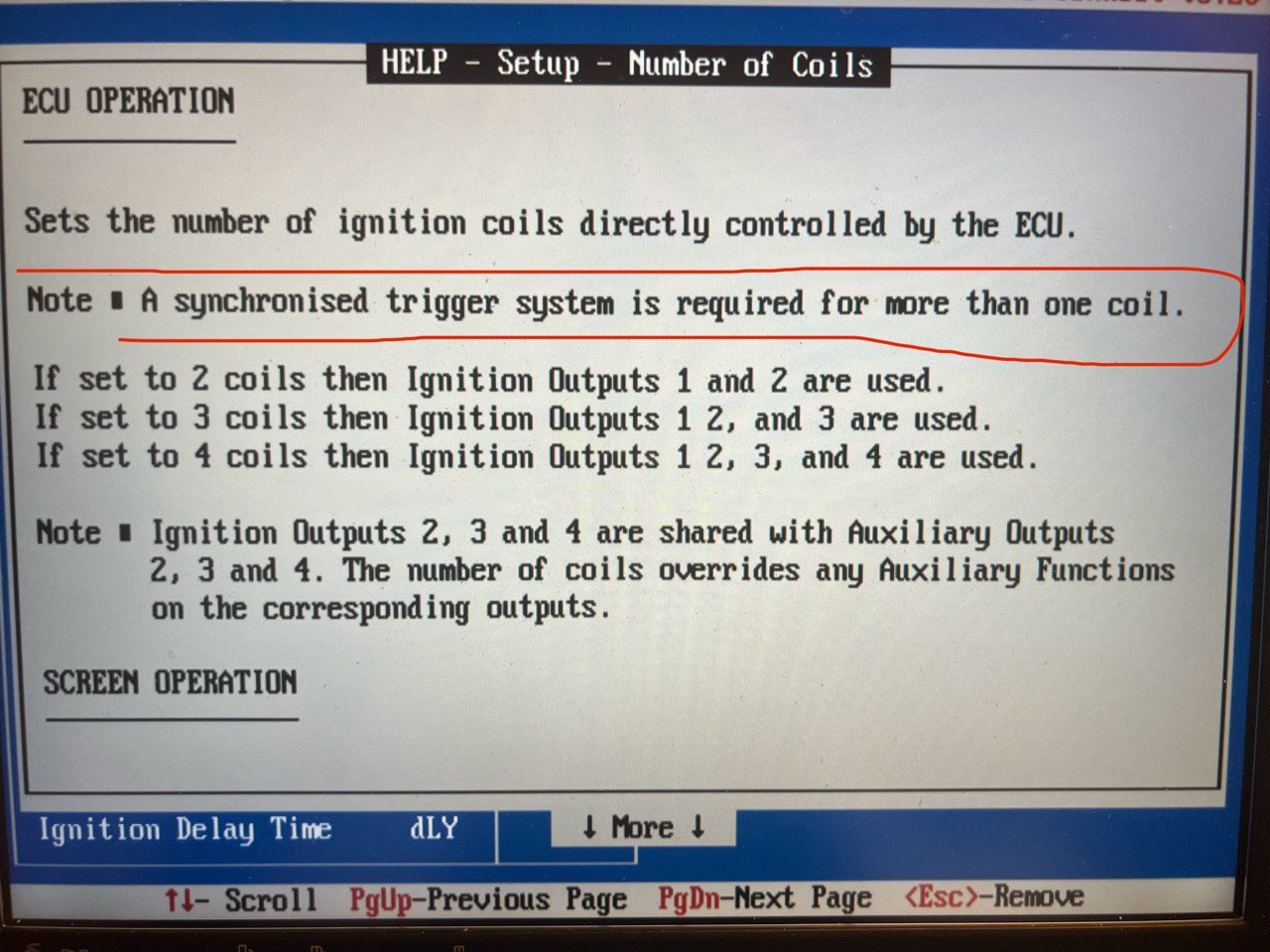

Stephen, please , tell me - "NOTE A" it means that it is impossible to use wasted spark mode (3 banks of paired COPS) without SYNC sensor?
w460
Posts: 10
Joined: Thu May 09, 2024 4:54 am
Re: Help needed with M4 aux ignition COPs
Postby Stephen Dean on Mon May 13, 2024 5:01 pm
That should have been injectors wired as batch fired.
