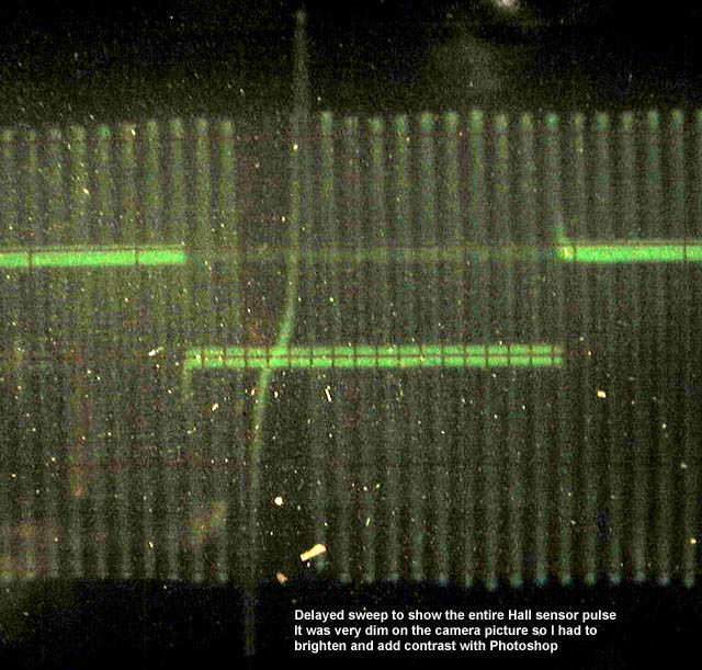

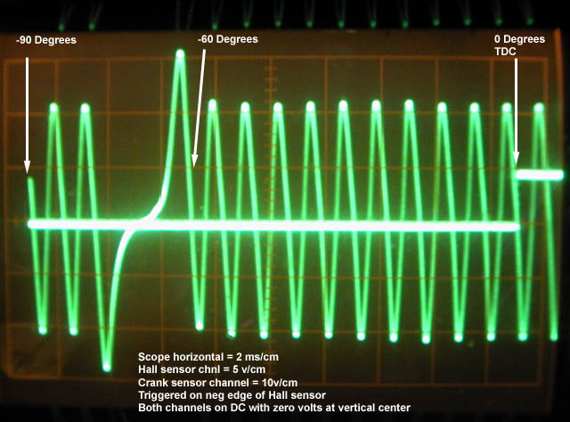

I feel that 73 is the likely desired mode, attatched are tests of the same sensors and engine on a friends car. The behaviour is also present with modes 71, 72 and 74.
Logging shows rpms (138 iirc?) and a clear sync event.
Timing pulses 2.jpg (97.68 KiB) Viewed 25300 times
Timing pulses.jpg (63.83 KiB) Viewed 25303 times

The car runs but I'd still like to hear some opinions on the above waveform and whether the mag and hall should be rising or falling, especially the hall because of it's unique trait of the trigger wheel's opening effectively making one really long 'tooth'. Would it be best to use 'falling' edge so as to avoid the rising one that's near TDC? Am I thinking correctly about what's seen above?

Use falling edge for the ref and rising edge for the sync. The sync edge ideally needs to occur between 110 degrees and 240 degrees before the index tooth(the first tooth after the missing teeth), your rising edge is closer to this than the falling edge is.

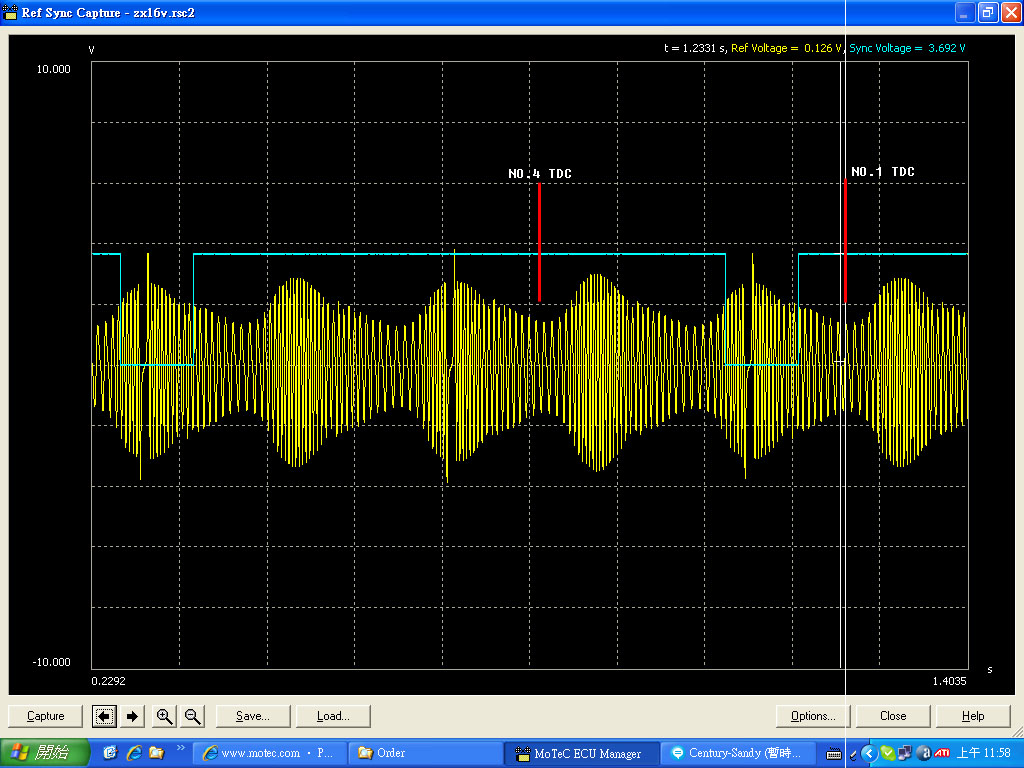

My situation is like this case.
I fit M800 on Citroen Xantia 16V engine.
It is also 60-2 missing mag ref and one pulse hall Sync.
My capture is here.
ref sync signal
Ref / Sync setting ,
Mode 7
CRT 60
Tooth Ratio 50
CRIP 117
REF Mag, fall, 0
SYNC hall, fall, 0
I can see the timing degree is 0 when I use test advance which been set to 0.
But the error sync signal and no sync was appeared.
Please help me to solve this problem.
Thank you so much.

Check your ref and sync filter levels, you can use the values described in the help file. It looks like the enmgine is not cranking over very evenly, try cranking the engine without any spark plugs fitted and see if it syncs up ok.
Also remember that any errors will remain present unless you manually re-set them. It is quite common to get some errors as the engine starts to crank over but that clear straight away. Does this engine run?
