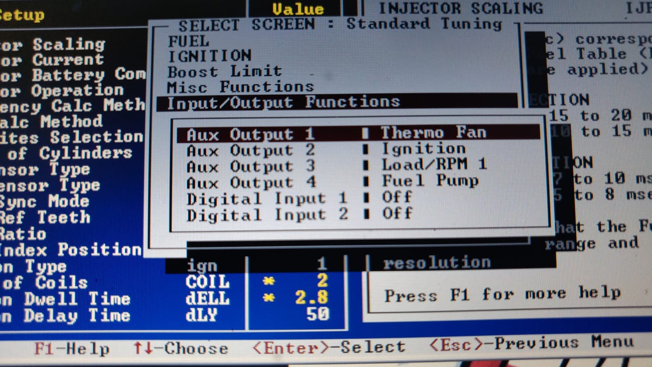

Re: Why is my aux 2/ign 2 output not working on my M4
PostPosted: Tue Jul 18, 2023 11:22 pm
by dong
PostPosted: Wed Jul 19, 2023 10:31 pm
by dong
Did my configuration reveal anything that may be the cause of my issue?
