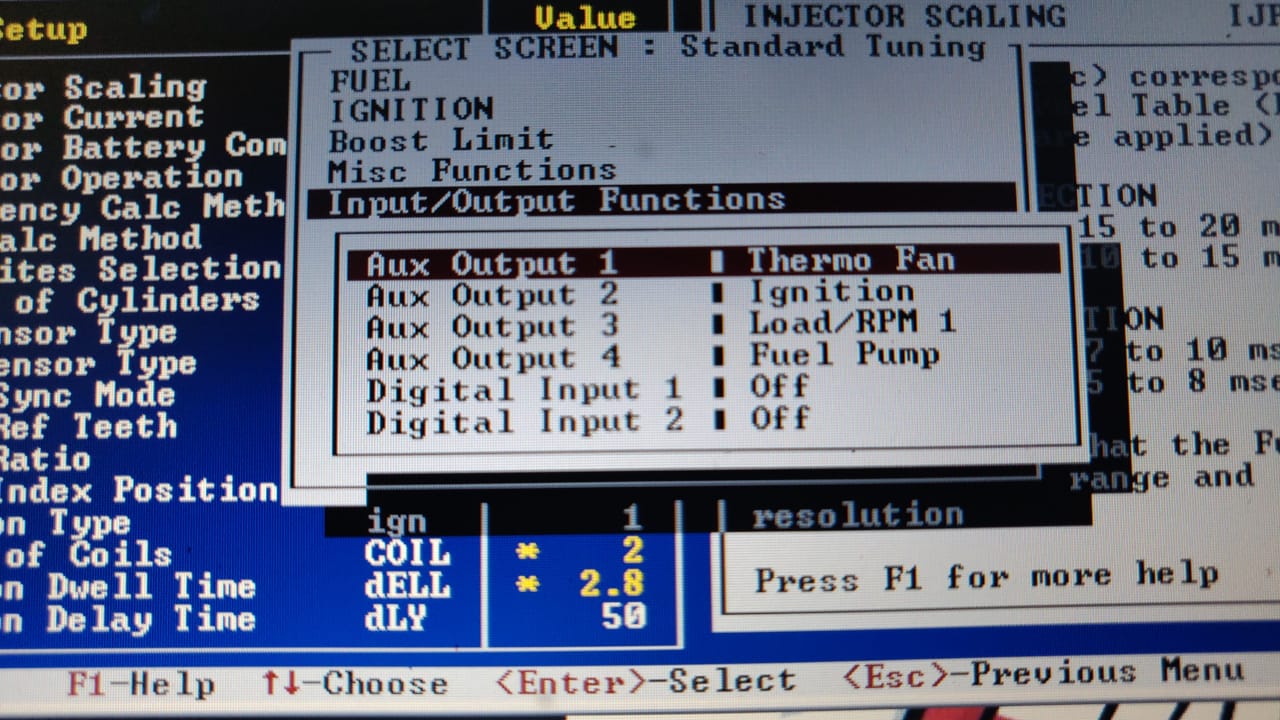

I am using wasted spark to drive 4 COP on a honda b16 engine but I am not getting any output from aux 2/ign 2. What could be the cause? In diagnostics you hear the sound from ign 1 but nothing from ign 2.

Do you have any function, such as the Fuel Pump or Cooling Fan allocated to Aux Output 2?
Have you changed the Number of Coils in the Main Setup to 2?

Nothing else is assigned to it and the number of coils is set at 2

Can you attach the configuration from your ECU here?

Did my configuration reveal anything that may be the cause of my issue?
