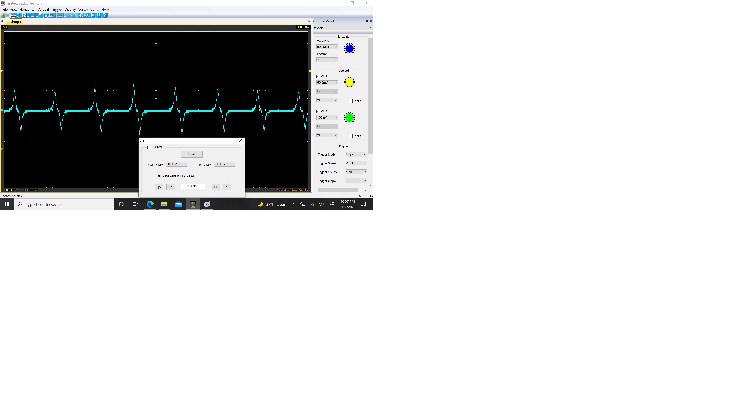

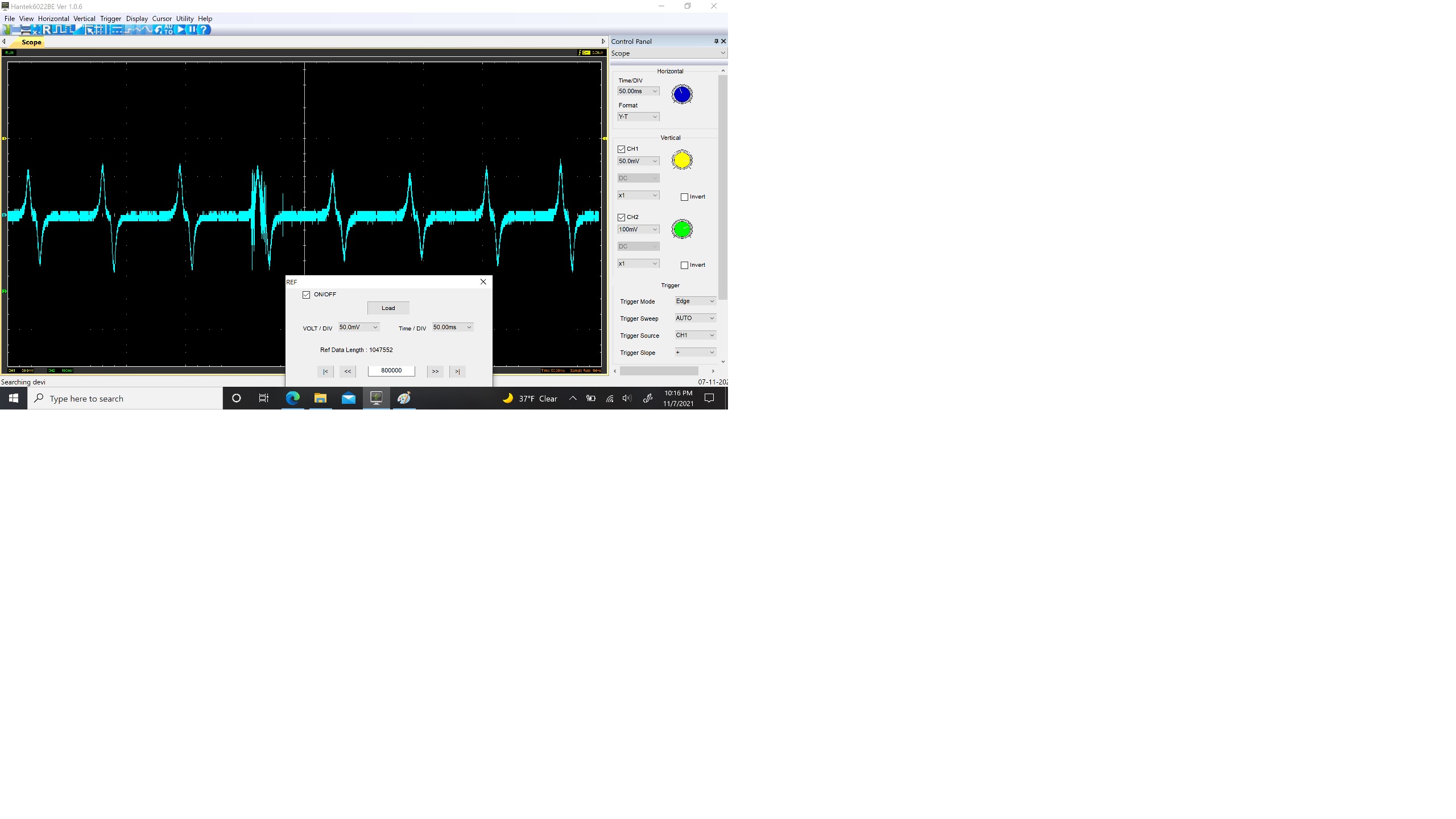

I tested a suspected bad mag sensor (crank position sensor) with an oscilloscope. I tested it while cranking with the sparkplugs out - first at the sensor plug, and then at the Motec ECU plug to hopefully account for possible bad wiring.
Do these waveforms look OK? Two observations:
- The center line looks a little fatter than I expected.
- One of the waveforms in the first screen shot looks mis-shaped. Could this represent some interference that could cause issues in the signaling to the ECU? I'm not sure if this is within the realm of normal to see in the output of an oscilloscope.
Thanks.
Scott

The signal at the ECU looks OK apart from 300mV peak to peak seems a little small.
Is this pattern for one tooth per cylinder?
What sensor and teeth combination are you using?
What is the gap from the tooth to the sensor?

I should've mentioned the scale in the screen shots. The yellow marker on the vertical axis is 50 mV, so the peaks in the waveform are 25-35 mV.
The sensor is a Motec M 3025 SS13 / #52002 "small mag sensor" similar to the threaded one that Milspec Wiring now sells. https://www.milspecwiring.com/4-APX-001 ... p_427.html
The recommended air gap for these sensors is .012-.025". I had set it to .015" and recently checked for a full rotation and found some variation in the gaps with each of the teeth .009-.015"
The crank sensor wheel is a 6 tooth wheel, no missing or extra teeth. Not sure why this setup choice was made. There is a synch sensor on the cam. It's a 4 cylinder engine. I can say the engine ran well previously, and old logs show no synch or ref errors.

You can see the tooth height difference in the wave forms but 25 - 35mv is too small on the REF input.
Are you using x10 scope probes which would mean 250 - 350mv?
What revision is the ECU PCB?
Are you using V6.2 software?
If so you could change the REF input type setting to one of the low voltage ones. Press F1 to see the options.
On the other hand you could simply have a bad sensor with shorted winding's which could lower the output voltage of the sensor.
