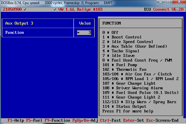

Hi all,
I am working on an old M4, where the plan is to use AUX 3 to control cooling fan (PWM),

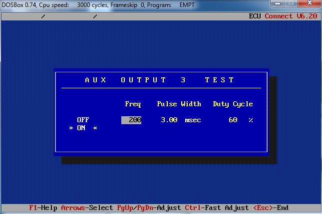

Everything works fine when I am using "test output" (200Hz. from 10% to 90% (below 10 and above 95 it is "off")
But when I am in "normal mode" (with correct values in table etc...), and simulate changing ET (=X-axis) nothing happens, output AUX 3 is always =0.
Have I missed something.....?
EDIT (added screen-shots)
Aux Output 3
Aux Output 3.png (32.8 KiB) Viewed 8883 times
Aux Output 3 Test
Aux Output 3 Test.png (29.02 KiB) Viewed 8883 times

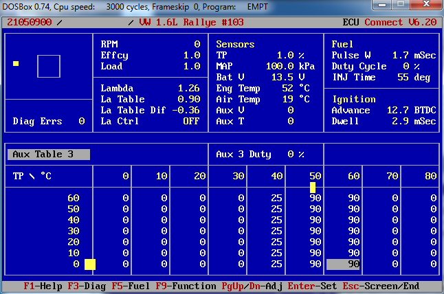

Aux Output 3 Table
Aux Output 3 Table.png (34.48 KiB) Viewed 8883 times

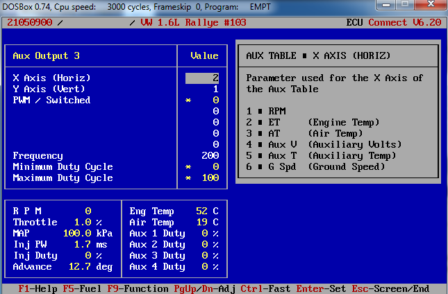

Postby LOLA-Christian on Tue May 11, 2021 12:17 am
Aux Output 3 Parameters
Aux Output 3 Parameters.png (36.87 KiB) Viewed 8882 times
(only three attachment in one post.... :cry: )

Postby LOLA-Christian on Thu May 13, 2021 12:26 am
SprinterTRD wrote:Basic question, I know, but how many ignition outputs are you using?
Two Ign Outputs (33 & 34)
Got information from Support, everything is OK - AUX 3 is only activated when system is "active" (= engine is running)
