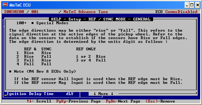

The help for ref/sync mode - general is where you will find the table (see below). The ranges are always in the same order, so for example 71 is rise/rise 72 rise/fall etc etc

could someone please give me a link to that help pop-up. its nothing like what i get on either of my M4 or M48. i am trying to sort out same issue. thanks

You can see the path to the help in the help window title bar. So open EMP, Use Adjust, then General Setup, then Main Setup, then select the Ref/Sync Mode line, and press F1. When the windows pops up asking for which help, choose the first line "General". Then use the up/down arrow keys to scroll
