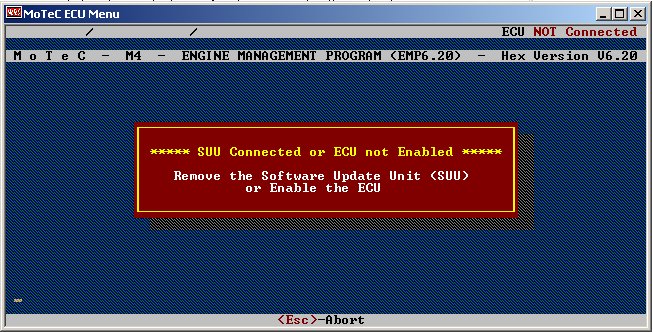

We have experienced the same issue with our M4, I don't know which version they were going from or to but the result is the same. The serial # is greater than 3000, is there a method to reset the ECU back to where it was before? How do we fix this? I have attached a screen shot of the error message.
Screenshot of error message

Postby NathanS on Tue Apr 21, 2009 12:47 am
Could you tell me what operating system was running on the pc that was used to upgrade the ECU, whether you were using a serial cable or a PCI cable and what connection on the PC you were using e.g. direct connection to the pc com port or a USB to serial converter.
One possible fix for this error is to connect the ECU to the PC as per normal and power it up but instead of opening the ECU Manager software go to C:\MoTeC\M4-v62 and double click on the Send.exe icon, this will launch a DOS window and should then resend the hex to the ECU.
If this does not work you will have to contact your MoTeC dealer and arrange to have the ECU sent back to us for repair.

Re: ECU upgrade failed
Postby SombiriE on Mon May 11, 2009 8:48 am
NathanS wrote:Hi,
I tried this last night and after the file loaded I was able to connect to the ECU. This fix works thank you.
