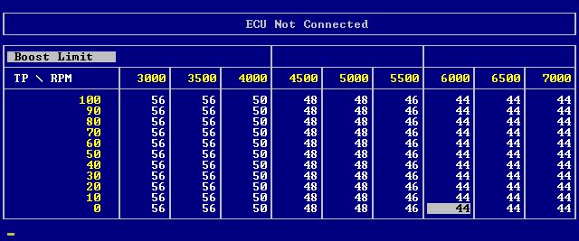

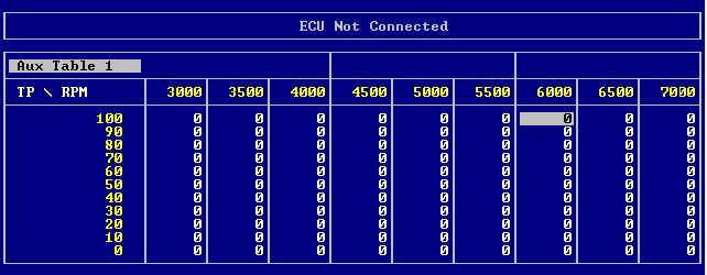

Hi folks,
Is it possible to drive the boost solenoid via an Aux table with RPM and TPS? If so how are the main boost table and the various trims / compensations treated.

Boost by TPS:

What are some starting points for turning boost by TPS for circuit racing orientated throttle response?

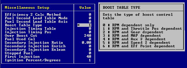

So it appears it is simpler than that and just under General/Misc Settings.
Boot by RPM and TPS.JPG (49.57 KiB) Viewed 7583 times

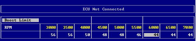

Any tips on how best to blend the TPS axis
