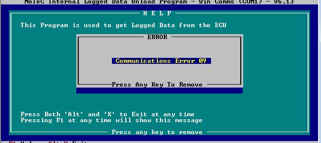

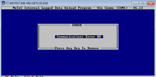

Hello folks,
I am getting good snappy navigation when connected to the ECU but have only managed to download 69k at the most from a GETLOG. It seems really flaky. I can see that there are numerous updates to for USB to serial compatibility in later versions. Is there anything I can do to tweak my interface settings or EMP config to have GETLOG work reliably on 6.1 or do I need to upgrade the ECU to 6.2 and then the EMP to the latest version? I would prefer to get it working reliably as is first if possible.
EMP 6.13D
ECU M4 1454 6.1
Windows 7 32 bit Virtualbox (not using XP for I2 compatibility)
9600 8 none 1 none, Buffers 64B timers 1ms (I notice that EMP work well at 19200 as well but GETLOG is bad on all settings)
Error examples: 09 03 and 0B so far.

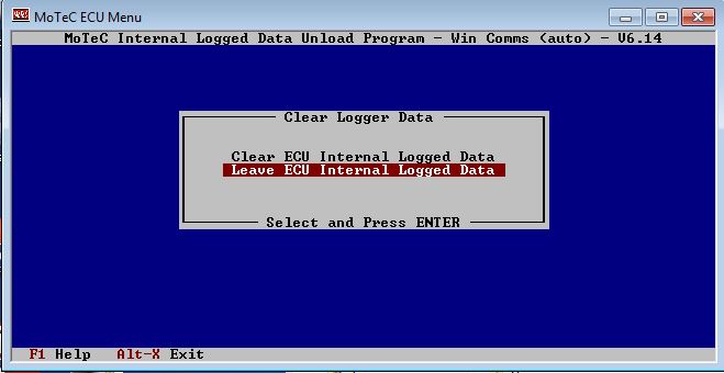

Resolved!
I copied the 6.15 EMPT.EXE file into a working 6.20d install to work around the 6.1 <> 6.2 ECU hex to EMPT incompatibility and ended up with GETLOG working a treat even at 19200. Looks like there is definitely an issue with the 6.13D comms drivers that is resolved in 6.20D.
