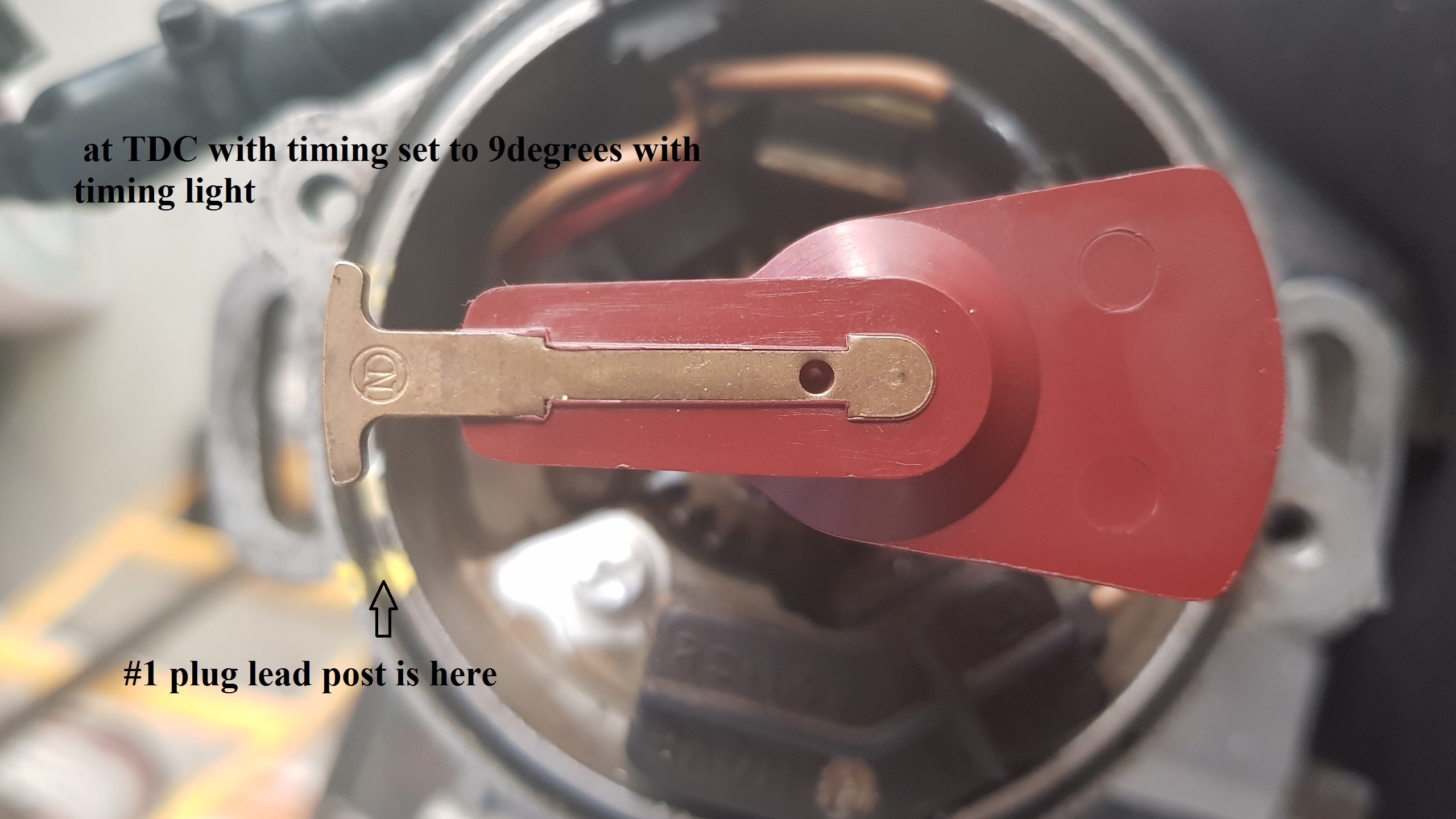

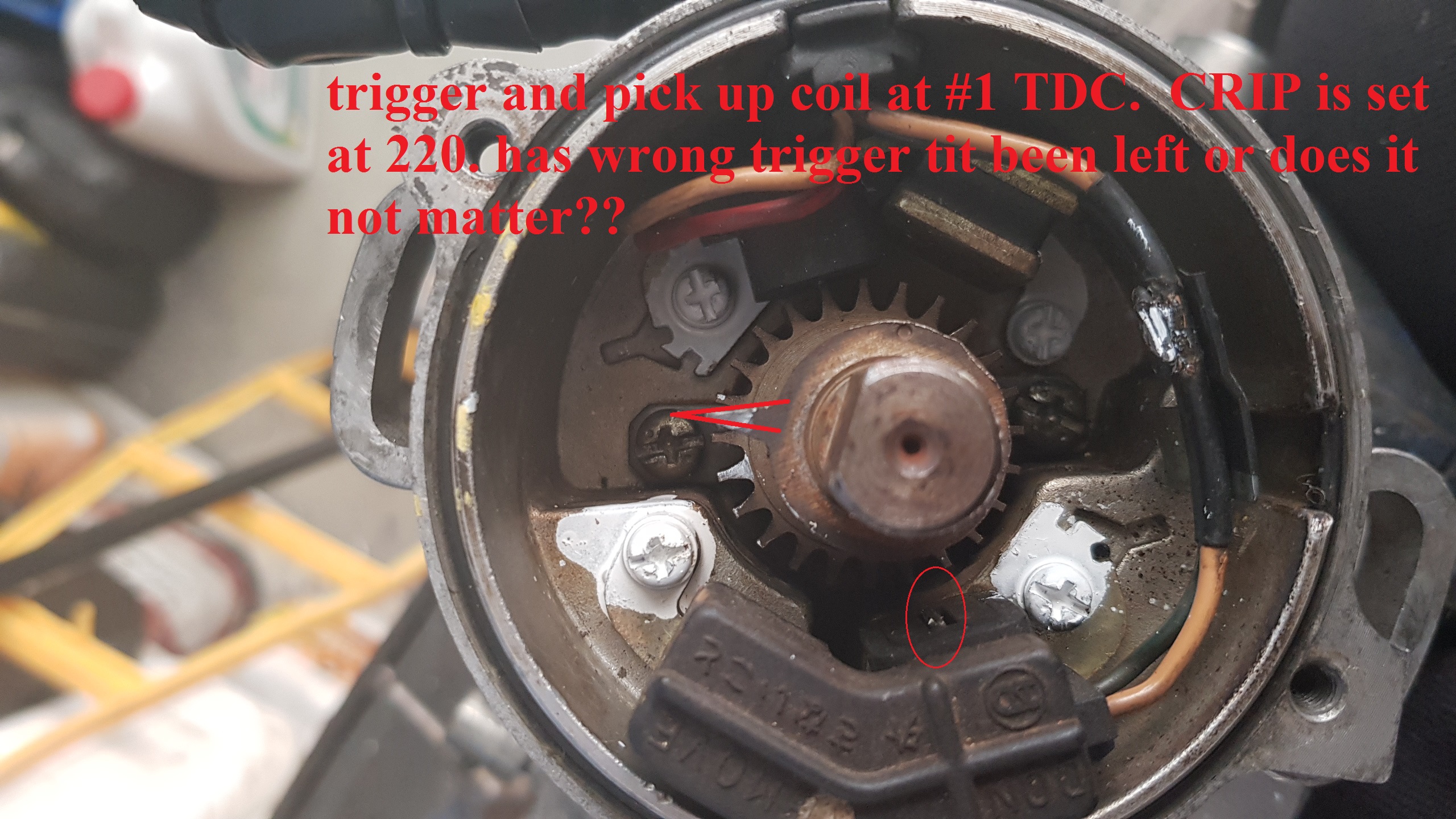

i attach a couple of pics of the setup. The dissy is set to align with motec at 9 BTDC when cranking at 300rpm
it appears the rotor arm is past the #1 terminal post at 9 BTDC and well past it by TDC . when installed, its very hard to get an accurate reading on that
the only reference trigger is about 100 degrees past #1 firing point. The CRIP is set at 220. Would that suggest someone filed off the wrong triggers???

The CRIP for that setup should be around 6 degree for a standard cam.
Are you using the correct rise & fall settings?
Have you checked them with a scope?
If not have you wired them per the MoTeC trigger drawing and used the suggested values ?
I would guess its a modified cam has it been indexed correctly?
If its a welded up cam have they kept the lobe centers relative to the distributor gear the same as the standard cam?
Set the crank to 10 deg BTDC
Set the distributor so the end of rotor button sits facing the no1 distributor post. Make sure you choose the correct end so when you advance the timing it would travel across the rotor button.
Fit the cap
Take the spark plugs out
Set the test advance in to software to 10 deg BTDC
Crank engine
Adjust crip to the 10 deg mark lines up with the crank
Its that simple!
