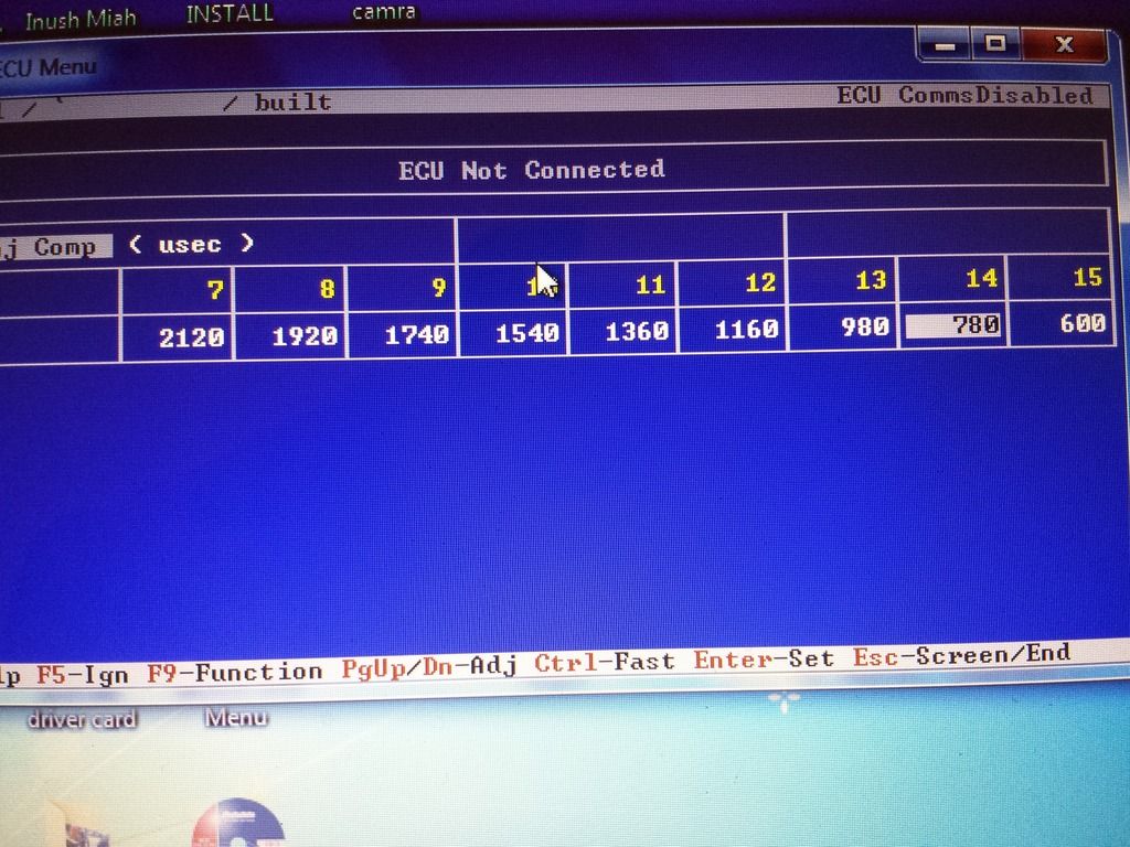

Im trying to put the dead time into motec but failing i have set the injector battery comp to 4 for now
As the numbers in the box i cant make sence
At 14v its 780 is the 0.45 put into same box as 450?
And then what do i do for the other voltages
Also another problem is i have set the injector scale to 10
But the table values are to low and very rich so i had to trim the injectors to -40% better but would like to keep trim to 0 and sort it out properly thanks

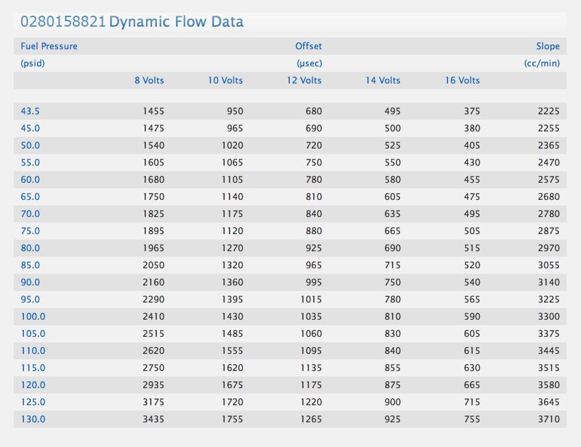

Just found this can i use an avrige for between voltages ? Image

For your battery comp, use the table at the bottom of your post, choose the row that suits your fuel pressure and interpolate the missing values, just use 1455µs for all cells below 8 volts.
To correct your fuel map, first set the trim back to 0, then go to fuel map and with any cell highlighted type "0.6T*", that will multiply the whole table by 60%. Next go back to the general settings menu and change IJPU to something smaller, select yes when the message pops up asking if you want to interpolate to fuel table, that should make the fuel map numbers bigger without effecting the tune much.

thanks very much i tryed putting them numbers in but runs very bad then emailed the company back and they sent me another set of dead times lol they must have sent me the wrong times
Volts 8 9 10 11 12 13 14 15 16 17 18
ms 2.273 2.045 1.864 1.682 1.545 1.455 1.364 1.273 1.227 1.182 1.136
another problem i have is the motec only goes up in 20ms at a time so i cant type the exact numbers in e.g. 14V should be 1.682 but i can only punch in 1680
will this cause a problem or nothing to worry about ? thanks again
