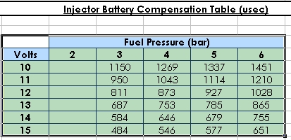

Has anyone got the correct IJbc number for the dead time compensation curve for Sard injector that is carrying Nippon Denso part no on the side of housing that is as follows 195500-2240.Impedance for injector is 14 ohms.
It will be running on a SR20det engine running standard fuel press reg.I believe these regs are rising rate can someone confirm this?

At this point, we havent done a full calibration of that particular injector, so we dont have a full curve of it for you.
In that instance we suggest that you follow the dead time comp curve for an injector with simmilar characteristics.
Use this one with is another 14ohm denso injector with a simmilar part number.
