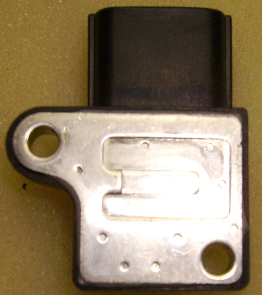

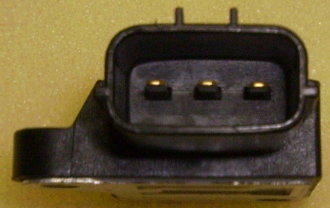

Postby Martin on Sun Oct 05, 2008 7:22 am
Igniter

Postby MarkMc on Thu Oct 16, 2008 10:07 am
That module is a Bosch BIM 034 or a BIM 085, the connectors are different between the two.

Re: M48 - COP
Postby Martin on Thu Oct 16, 2008 4:05 pm
Hi Mark,
Refering to the module above? Its a Mitsubishi and all 3 pictures are of the same igniters. The connector is very similar to the Nissan VQ coil connector, you could even use it if you cut they keyways of the igniter. This Igniter is found on the Mitsubishi Rodeo 3.0 V6 Pickup.

Postby MarkMc on Thu Oct 16, 2008 4:47 pm
The BIM 034 has a Junior Timer (L-Jet) connector which is usually easier to get hold of.
Some of the Hondas have COP ignitions with built in igniters these days, was trying to find exact models but can't think of any.
