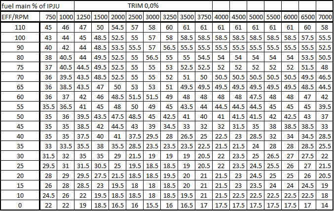

Postby erwan914 on Wed Feb 20, 2019 1:53 am
Fuel Map data

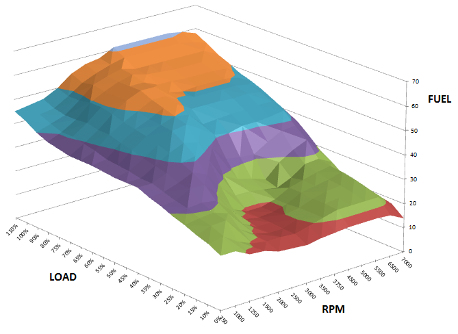

Postby erwan914 on Wed Feb 20, 2019 1:57 am
Fuel Map 3D Curve

Postby erwan914 on Wed Feb 20, 2019 3:18 am
This fuel map was created by a company with the car on a rolling road.
erwan914

Postby David Ferguson on Wed Feb 20, 2019 4:16 am
My suggestion before changing the fuel map:
-- verify that all the sensors are providing reasonable values (engine temp, fuel pressure)
-- particularly check the Throttle Position for smooth operation and that it's calibrated 0-100%.
-- verify the CrIP (i.e. commanded ignition timing equals actual ign timing)
When all that's good, then you need to determine where the engine is operating when you experience problems. The M48 does have logging and you should be able to use the Interpreter program to view those logs.
To properly tune the fuel, you will need some wideband lambda data -- I don't remember if the M48 had that, or if it would be possible to connect an external wideband to one of the M48 inputs so that data was logged.
