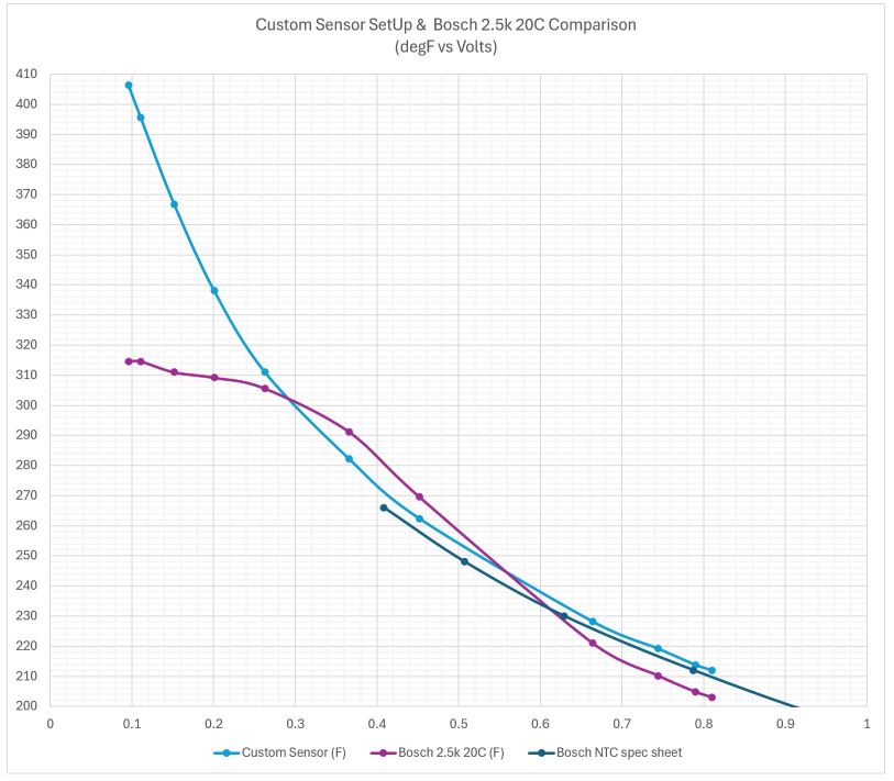

Postby JoeMag on Fri Nov 08, 2024 7:51 am
Grabbed a breadboard with pot and went to town simulating temp sensor resistance changes to see what the canned "Bosch 2.5k at 20C" and the custom sensor set-up yielded as engine temp from the ECU. Graph says it all. ...above 300F canned senor setup is wrong.
Readings taken from ECU in C and I converted to F as I relate to that better.
