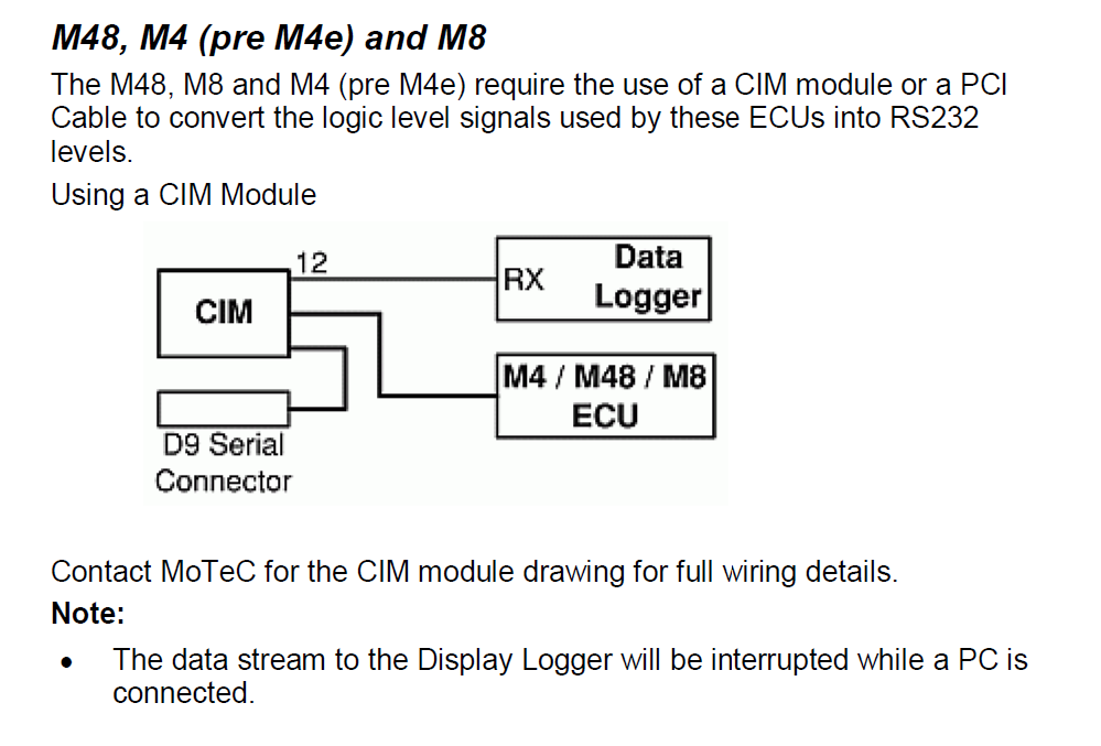

Hi, was wondering, as tech gets better is there a way I can get a digital dash to work with my Gold M48 . I brought a hand controller then found out it lights up but M48 doesn’t like hand controllers. Is for sale.
So a digital dash is wanted for the race car. If any one has a new or second hand working one that will work my application send me a dm.

The current MoTeC Colour Displays can work with the M48, you need to use either the PCI cable in the car or obtain a Computer Interface Module (CIM) to do this.
PCI to Dash connection.png (89.52 KiB) Viewed 10165 times

Thanks Steven,
So I have to buy a CIM ? I know you can buy canbus leads to suit early motec is this what I need? I was hoping I could use a power tune dash.
Ben
