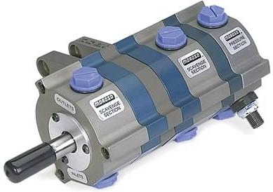

But I have still a problem with the oil pumps because I have to replace them and there is no part in stock. Everywhere it is not available.
