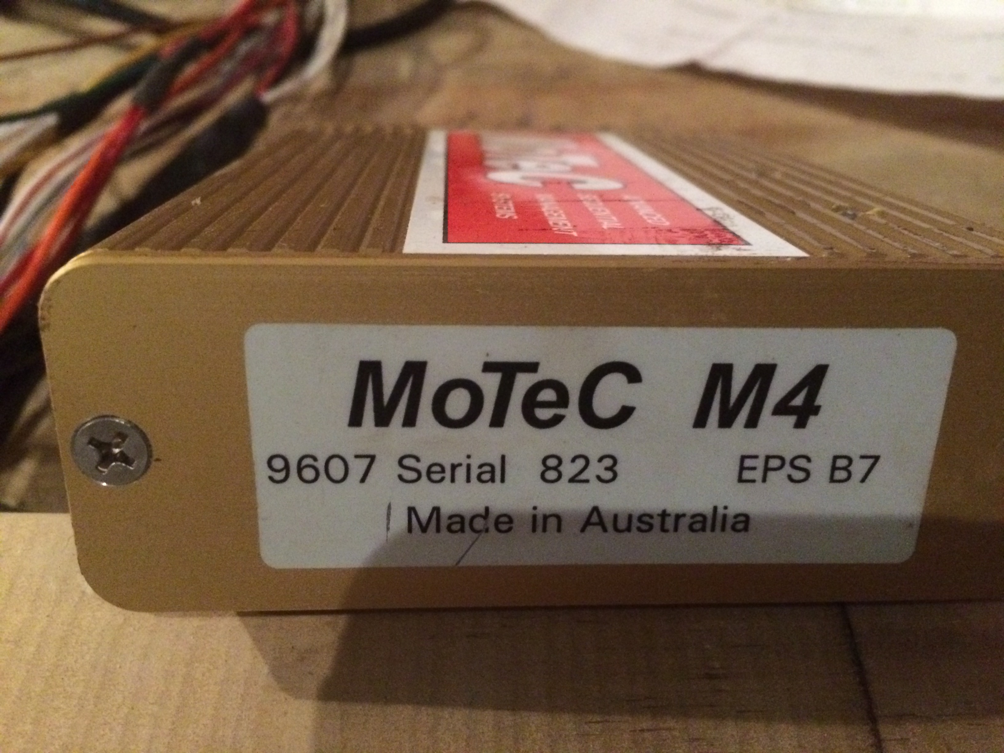

The Motec M4 pictured below was bought new many years ago for a project that didn't proceed. It's been sitting in a box complete with a new loom and sensors ever since. Going by the serial number ( in the 800's ) it must be quite an early M4.
Is there any reason why this unit shouldn't still work and can it be upgraded to last version of the firmware? Is there anyway I can get the unit to perform a basic self test before I go down the path of trying to install it?
Thanks in advance.

You will need a PCI or CIM cable to communicate with the M4, as well as a Software Update Unit (SUU) to be able to update the firmware, otherwise there should not be any issues.
For more information

Postby sam7 on Mon Apr 11, 2016 6:49 pm
Thanks Stephen,
I've sent it to Turboshop in Dunedin to get the firmware upgraded. Looks like the last firmware version was released in 2008 so I guess there's unlikely to be any further releases and not much point in me owning a SUU.
Sam
