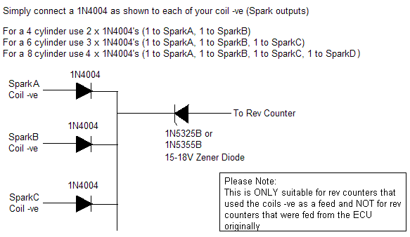

To drive a tacho from wasted spark coils you need to use a "ignition combiner" or sometimes called "tacho adaptor". Motec have them: http://www.motec.com.au/filedownload.ph ... docid=1203, you can find schematics online if you want to make one yourself, or available from companies like MSD also.

You may find the tacho in the car has an adjustable pot inside it that will allow you to adjust the reading for the reduced number of pulses from a single coil.
Or you could perhaps feed the 4 ignition outputs into a 4 channel amp, then combine the amp outputs to run the tacho ?
That should keep the ecu outputs isolated from the combined trigger.

Postby andy_hstad on Sat Aug 02, 2014 2:16 am
thanks for all quick replays.
what do you think about doing like this
